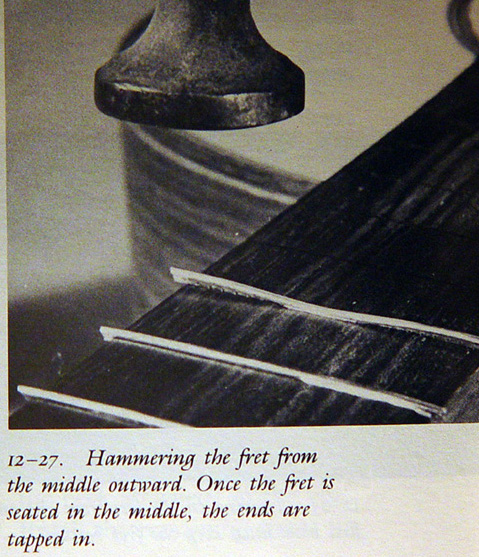

I'm ready to install the frets on my first guitar (a Classical). I have the frets cut 1/4" longer than the F/B, and slightly curved. Most of my books just say "hammer the fret in", but C&N suggest hammering in the middle until seated, then hammer the ends.
Sloane suggests hammering down the ends a bit to "crimp" them in.
I'm confused, since the C&N method left me with kinked frets on a trial excercise.
How do you Classical builders install the frets?

I start the fret with my fingers, then tap in the ends, then work towards the middle. I use a small (1 lb or less?) dead-blow hammer which has a hard plastic face, and back up the neck with a bag of shot. When I'm working over the body, I hold a weight (the head of a small hand sledge) inside against the underside of the top- if necessary I put a block of wood in to make sure I'm not resting the weight on the brace(s).
I know I would have major problems using the steel hammer shown in the pic from C&N. It's probably like many jobs- an expert who has 'the touch' can use one of many tools and do good work- a novice needs the help of the right tool for the job. For me, that's a plastic-face dead-blow hammer.
